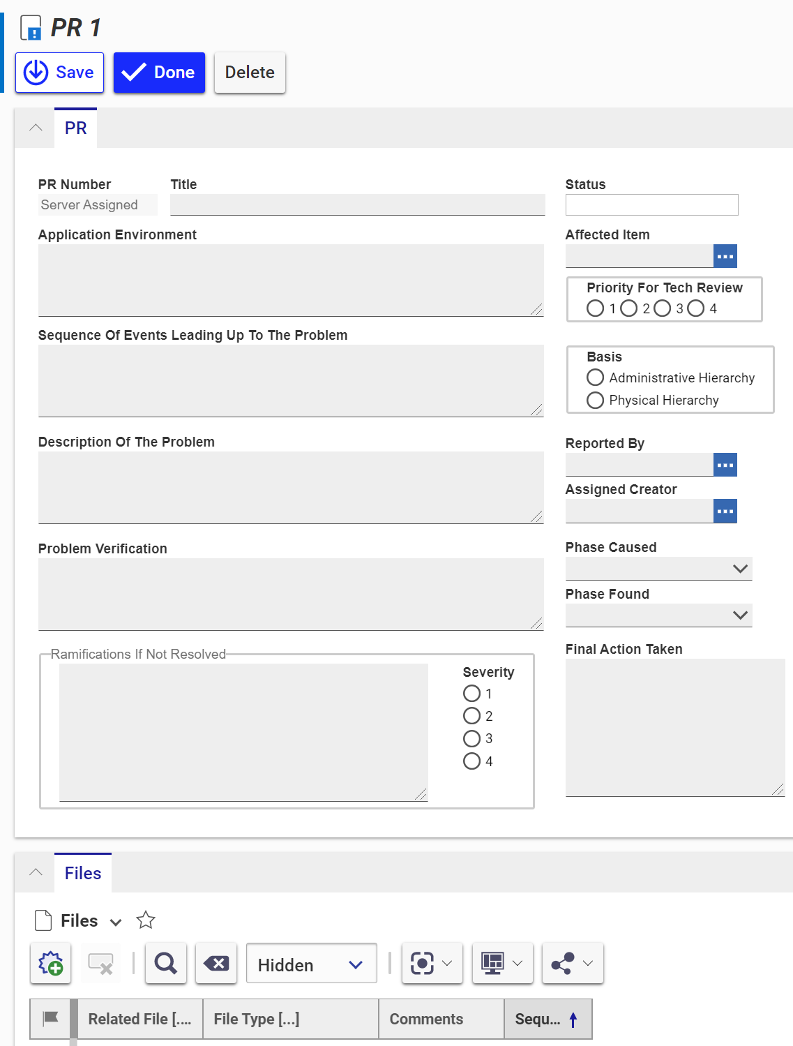

A PR is a complex document that is filled in by different roles in the system. A PR creator is not expected to fill in the PR completely. This section defines the types of information that must be included in a newly created PR.
To create and submit a Problem Report:
  1. Go to Contents à Change Management à PRs.
  1. Click Create New PR. The view of a new PR appears. Enter the necessary information.
Graphical user interface, application
Description automatically generated
Figure 238.
  • Title – The title for the PR. The title should be as descriptive as possible.
  • Application Environment – The background information about the product and/or any related problems. For example, it could be the version or the server used for a software product, or it could be the temperature and the humidity level for an automotive part.
  • Sequence Of Events Leading Up To The Problem – The exact steps taken that led to the problem.
  • Description Of The Problem – A description of the problem. The description should describe the problem as precisely as possible.
  • Affected Item – The affected item.
  • Basis
  • Physical Hierarchy – The Item (Part) itself and any Document associated with it. A bug in software would be classified as a physical hierarchy.
  • Administrative Hierarchy – Anything related to the process of running the business. An error in an expense report procedure would be classified as an administrative hierarchy.
  1. Click Done on the PR toolbar. The PR is created and submitted for a CSI’s decision.

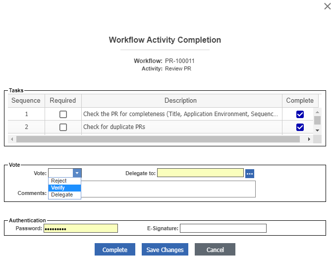

Reviewing a PR
A CSI receives a Submitted PR to decide whether to reject or review it. This section defines which pieces of information the CSI must provide when the decision is made to review the PR.
Use the following procedure to review a Problem Report:
  1. Open the PR view.
  1. Click Edit on the PR toolbar.
  2. Specify the priority number in the Priority For Tech Review field. The higher the priority, the lower the number selected.
  3. Enter the name of the person who reported the problem in the Reported By text box. This Identity may not be the same person who created the PR in the system (the Creator).
  4. Enter the name of the PR Owner in the Assigned Creator text box.
  5. Click Done on the PR toolbar.
  6. Go to Contents à My Innovator à My InBasket à Search My InBasket.
  7. Go to the Workflow Activity Completion dialog for the PR.
Figure 239.
  1. Mark the tasks you completed in the Tasks field.
  2. Select Verify in the Vote list.
  3. Click Complete.
The PR awaits a decision of the PR Owner.

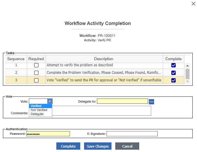

Verifying a PR
A PR Owner receives a PR In Verification to decide whether to reject or verify it. This section defines which pieces of information the PR Owner must provide when verifying the PR.
Use the following procedure to verify a Problem Report:
  2. Enter the steps that were taken to verify the problem as well as any special conditions or descriptions of the problem in the Problem Verification text box.
  3. Enter an assessment of what would happen if this problem was not corrected in the Ramifications If Not Resolved text box
  4. Assess the severity of the issue in the Severity box. The higher the severity; the lower the number selected.
  5. Specify the product development phase where the problem occurred in the Phase Caused list.
Figure 240.
  1. Select the product development phase where the problem was found in the Phase Found list.
  2. Click Done on the PR toolbar.
  3. Go to Contents à My Innovator à My InBasket --> Search My InBasket.
  4. Go to the Workflow Activity Completion dialog for the PR.
Figure 241.
  2. Select Verified in the Vote list.
  3. Click Complete.
The Approve PR activity starts. The PR awaits a CSI’s decision.

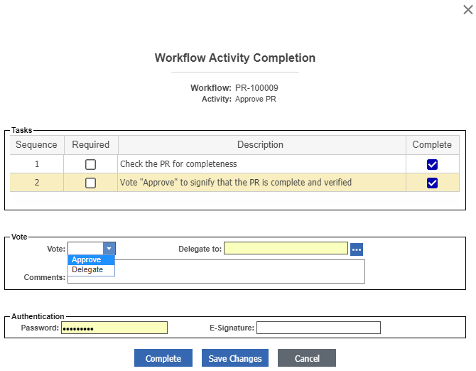

Approving a PR
A CSI is responsible for the final approval of all PRs in the system regardless of their creator, activity, or state.
Use the following procedure to approve a Problem Report:
  1. Check that all necessary information is present.
  2. If it is necessary to correct the PR:
  1. If any final action takes place, enter information about it in the Final Action text box.
  2. Provide any missing information.
  3. Correct wrong information if any exists.
  4. Attach auxiliary files if any exist.
  1. Go to the Workflow Activity Completion dialog for the PR.
Figure 242.
  1. Select the tasks you completed in the Tasks field.
  2. Select Approve in the Vote list.

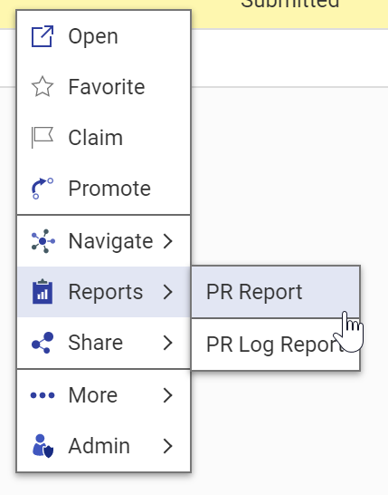

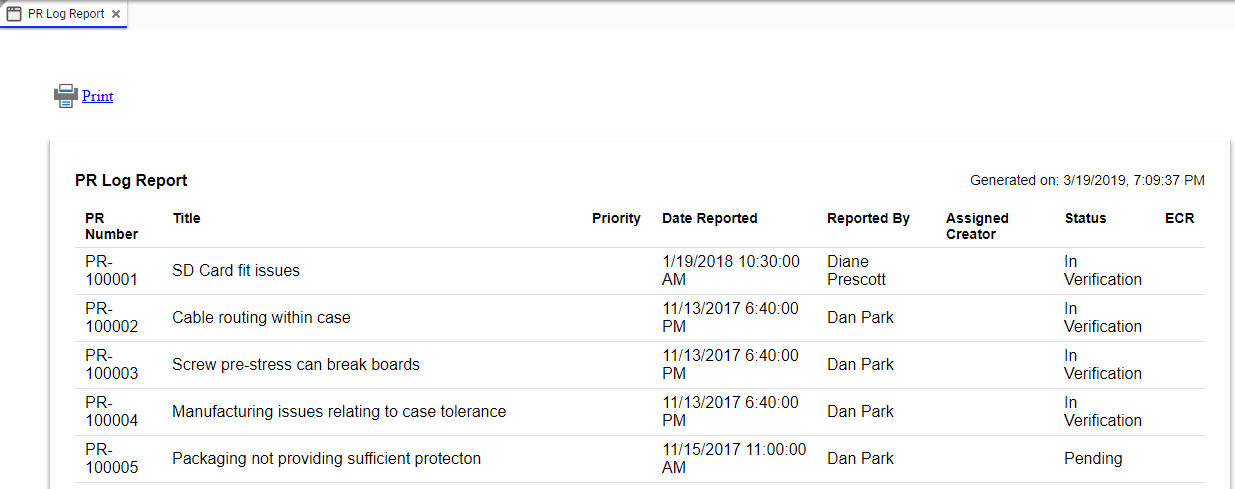

PR Log Report
You can get quick information about all the PRs submitted to Aras Innovator with the PR Log Report.
Figure 243.
There are several ways to access the PR Log Report:
  • Go to Contents à Change Management à PRs, right-click any PR, and then click Reports à PR Log Report.
Figure 244.
  • Open the view of any PR, on the PR toolbar, click Reports, and then click PR Log Report.
Figure 245.
To quit a Report, close its view in Aras Innovator.

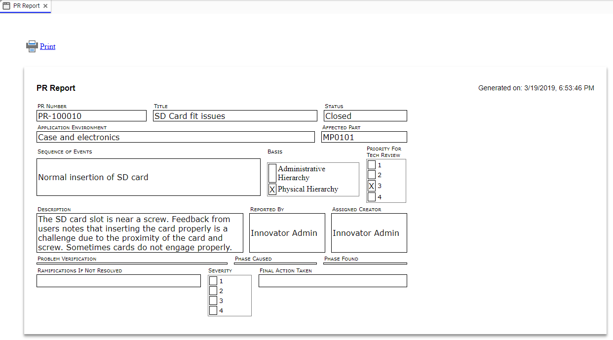

PR Report
You can print or share a PR using the PR Report.
Figure 246.
There are several ways to access the PR Report:
  • Go to Contents à Change Management à PRs, right-click a PR to be reported, and then click Reports à PR Report.
Figure 247.
  • Open the view of a PR. On the PR toolbar, click Reports, and then click PR Report.
Figure 248.
At the top left corner of the PR Report view, there is a Print button, which uses the standard browser print function. Depending on the browser and your specific configuration, various print choices, such as printing to a printer or saving to PDF, are available.

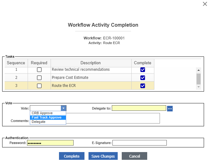

  2. The ECR enters the Technical Review activity assigned to the Owner. The Owner conducts the technical review and provides data, comments, and recommendations. Once the Owner votes Complete, the ECR goes further.
  3. The ECR enters the Route ECR activity assigned to the CSI. The CSI must decide how to route the ECR. Different companies have different criteria for making this decision based on the cost estimates, time, and the nature of the problem itself. The CSI has the authority to vote either:
    1. Fast Track Approve for a fast-track ECR. The ECR enters the Disposition ECR activity assigned to the Owner. The Owner votes either:
      1. ECR Approved to approve the ECR.
      2. ECR Disapproved to reject the ECR.
      3. Investigate to send the ECR back for more investigation.
    2. CRB Approve for full CRB involvement. The ECR enters the Prepare CRB activity assigned to the CSI. The CSI defines the meeting type either through an in-person CRB Meeting or through an Online CRB. The CSI also prepares all the necessary information to present to the CRB. Regardless of the meeting type, the CRB votes either:

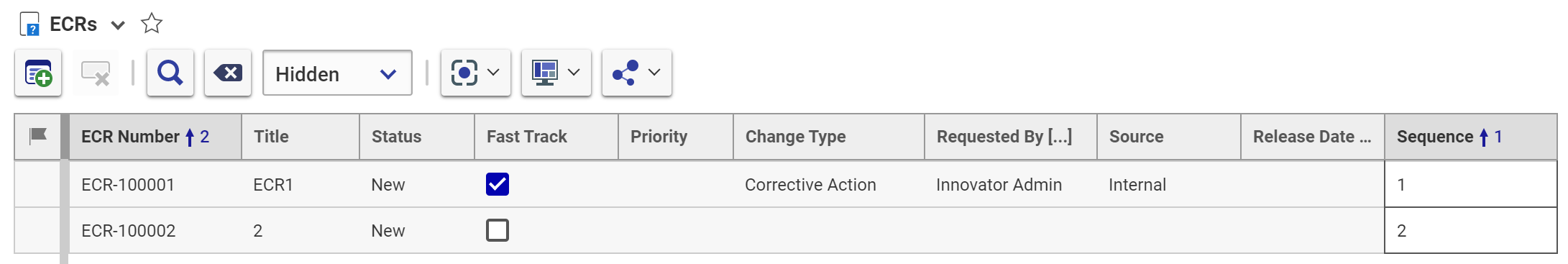

The ECR reports are:
  • ECR Log Report is a list of all the ECRs. For details, refer to section ECR Log Report.
  • ECR Report is a printable form of an ECR. For details, refer to section ECR Report.

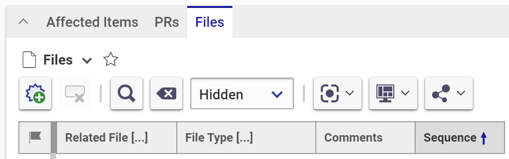

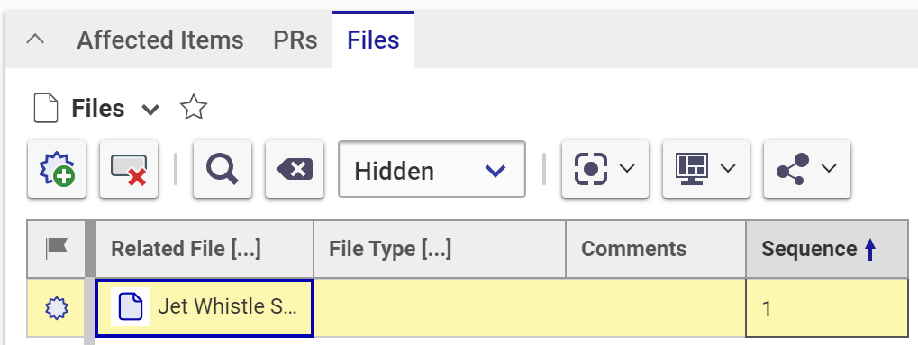

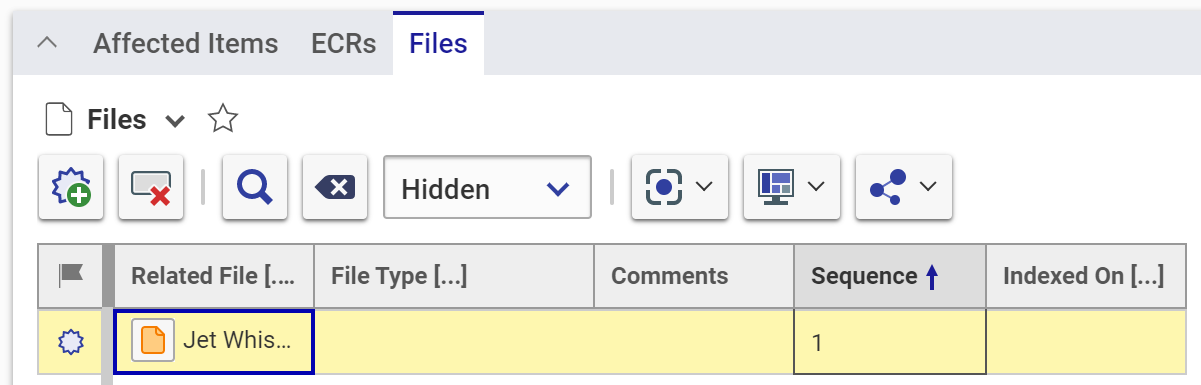

  8. Go to the Files accordion tab to attach all the files concerning this ECR.
Figure 252.
  1. Click New File on the Files accordion toolbar. The standard operating system dialog for file browsing and selection appears.
  2. Search for and select a file. A new row appears in the Files grid with the file attached.
Figure 253.
Note: Aras Innovator will automatically assign a file type depending on File’s extension when you save the ECR.
  1. If it is necessary to provide additional information about the File, enter it in the Comments cell.
  2. Repeat steps 14-16 for other files related to this ECR.

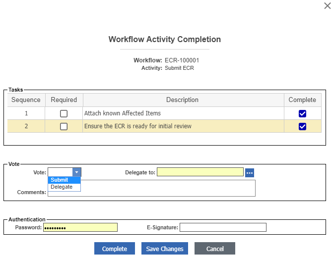

  3. Click Done on the ECR toolbar. The ECR is created. The automatic ECR properties get their values.
  4. Go to Contents à My Innovator à My InBasket à Search My InBasket.
  5. Go to the Workflow Activity Completion dialog for the ECR.
Figure 254.
  2. Select Submit in the Vote list.
  3. Click Complete.
The ECR enters the Review ECR activity and awaits the decision of the CSI.

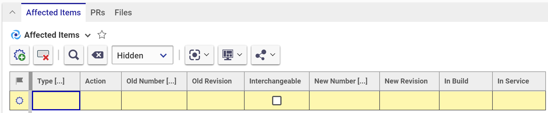

Adding an Item with an ECR
To request add and release of an affected Item with an Engineering Change Request:
  1. Open the ECR.
  1. Click Edit on the ECR toolbar.
  2. Go to the Affected Items accordion tab.
  3. Click New Affected Item on the Affected Items accordion toolbar. A new row appears at the bottom of the Affected Items grid.
Figure 255.
  1. Select Add in the Action cell.
Figure 256.
  1. Click the ellipsis button in the New Number cell. The Search dialog – Change Controlled Item appears.
  2. Search for and select the new affected Item. The affected Item populates the New Number cell.
Figure 257.
  1. Click Save or Done on the ECR toolbar. The ECR now has an affected Item that needs to be added and released.

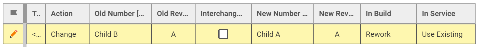

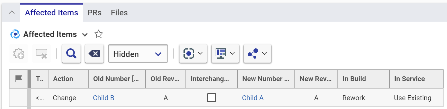

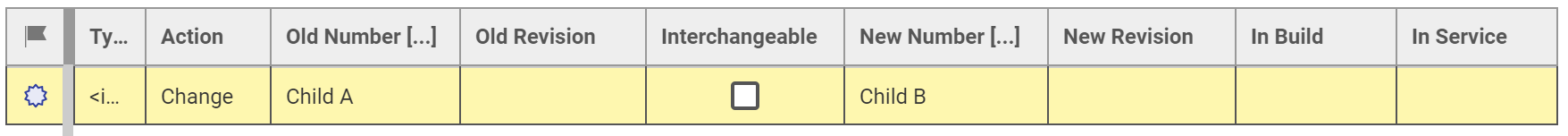

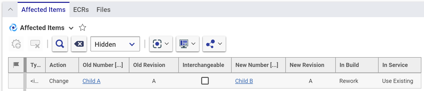

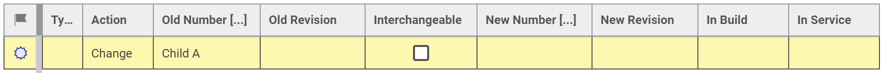

Changing an Item with an ECR

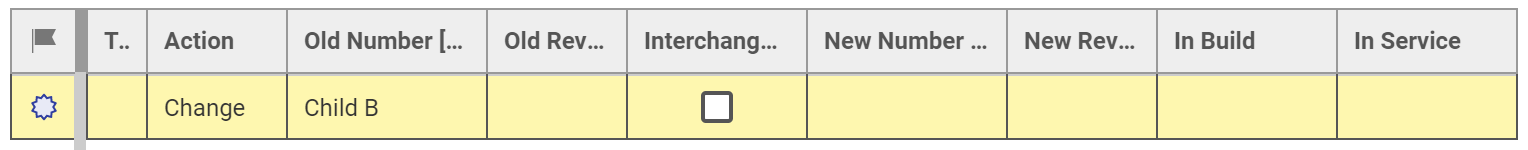

To request changing an existing affected item with an Engineering Change Request:
  1. Open the ECR.
  4. Select Change in the Action cell.
Figure 258.
  1. Click the ellipsis button in the Old Number cell. The Search dialog – Change Controlled Item dialog box appears.
  2. Using the standard search procedure, search for and select the affected Item to be changed. The selected Item populates the Old Number cell.
Figure 259.
  1. Select the Interchangeable cell check box if the old and new Items are interchangeable e.g., if there is no Fit-Form-Function change. When selected, the same Item number is retained. Otherwise, a new Item number will need to be assigned.
  2. If the Interchangeable cell is not selected, e.g., the old and new Items are not interchangeable due to a Fit-Form-Function change, select the replacing new Item:
  2. Search for and select the new affected Item. The new affected Item populates the New Number cell.
Figure 260.
  1. Click Save two times on the ECR toolbar.
  2. Select the action to take for the Items that are being built in the In Build cell: Use Existing, Rework, or Scrap.
  3. Select the action to take for the Items that are currently in service in the In Service cell: Use Existing, Rework, or Scrap.
Figure 261.
  1. Click Save or Done on the ECR toolbar. The ECR has an affected Item requested for changing.
Figure 262.

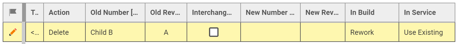

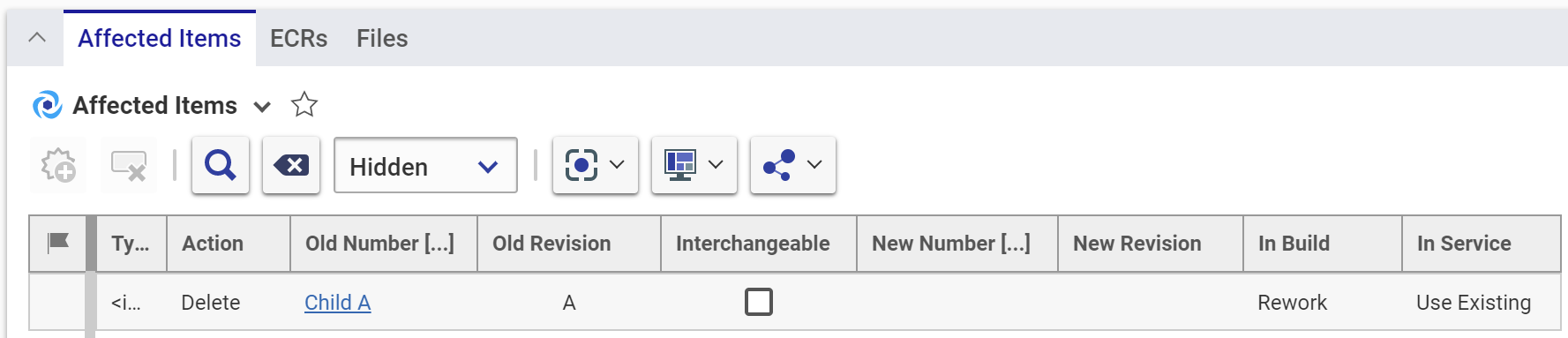

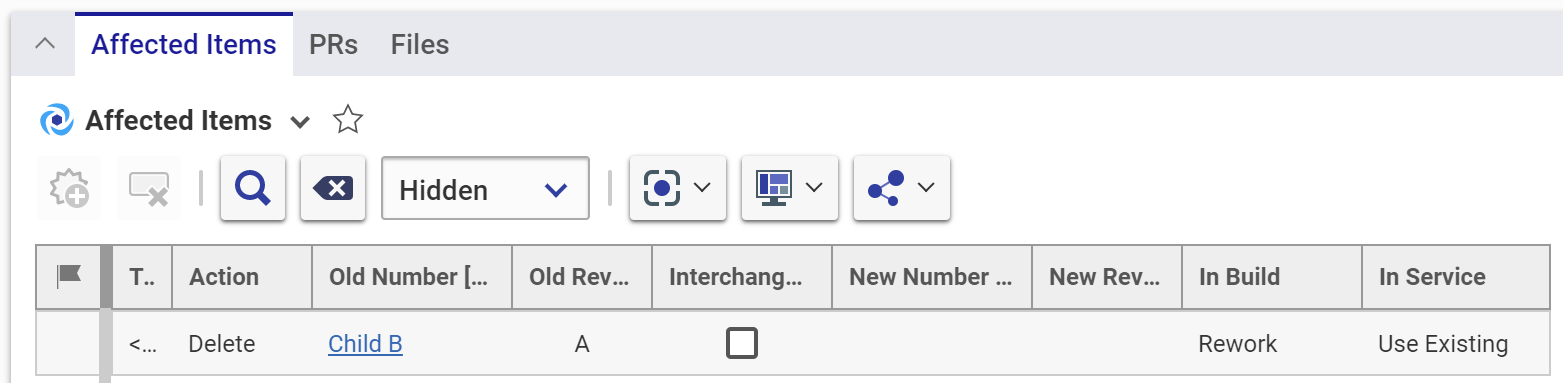

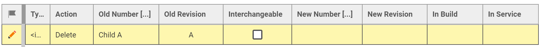

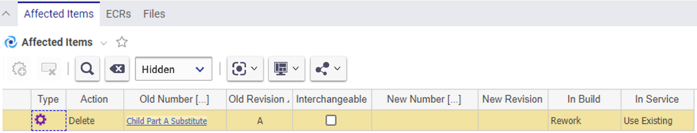

Deleting an Item with an ECR
To request superseding of an existing affected Item with an Engineering Change Request:
  1. Open the ECR.

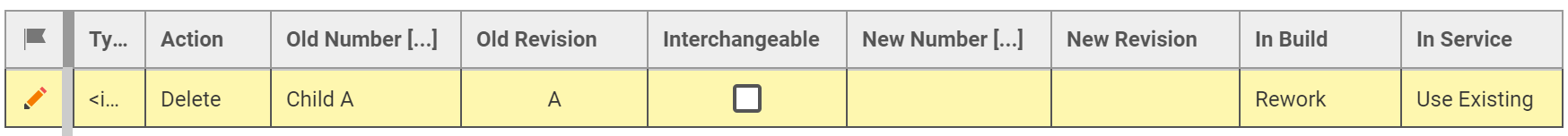

  4. Select Delete in the Action cell.
Figure 263.
  1. Click the ellipsis button in the Old Number cell. The Search dialog – Change Controlled Item appears.
  2. Search for and select the affected Item. The old Affected Item populates the Old Number cell.
Figure 264.
Figure 265.
  1. Click Save or Done on the ECR toolbar. The ECR has an affected Item assigned for deletion.
Figure 266.

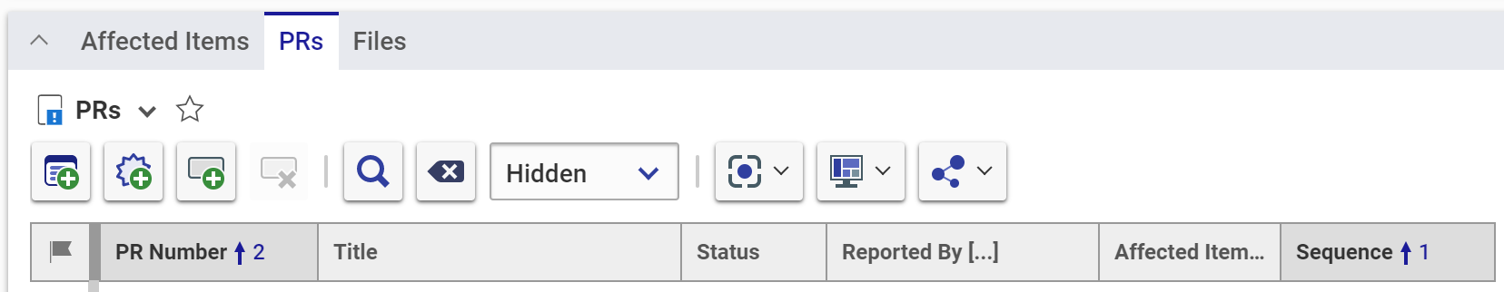

  7. If this ECR is based on a PR:
  1. Go to the PRs accordion tab.
Figure 268.
  1. Click Select Items. The Search dialog – PR appears.
  2. Search for and select the initiating PR. The selected PR appears as a bottom row in the PRs grid.
Figure 269.

  2. Go to Contents à My Innovator à My InBasket à Search My InBasket.
  3. Go to the Workflow Activity Completion dialog for the ECR.
Figure 270.
  2. Select Tech Review in the Vote list.
  3. Click Complete.
The ECR enters the Technical Review activity and awaits technical review by the ECR Owner.

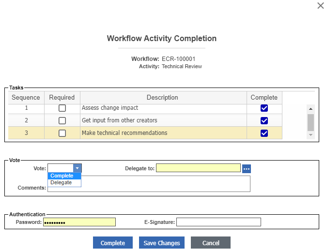

Figure 275.
  2. Select Complete in the Vote list.
  3. Click Complete.
The ECR enters the Route ECR activity and awaits a decision of the CSI.
Routing an ECR
A CSI receives an ECR to decide how to route the ECR: either Fast Track Approve for a fast-track ECR or CRB Approve for full Change Review Board (CRB) involvement. The CSI makes this decision according to the company's policies and procedures. This section defines which pieces of information the CSI must provide to comply with the CMII process requirements when routing the ECR.
To route an Engineering Change Request:
  1. Open the ECR.
  2. Verify that the information already entered in the ECR is correct.
  3. Double-check the Key Implementation Timing Factors text box to make sure it contains the correct data.
  4. Specify the implementation priority number in the Priority For Tech Review field. The higher the priority, the lower the number selected.
Figure 276.
  1. Click Done on the ECR toolbar.
Figure 277.
  2. Select either CRB Approve or Fast Track Approve in the Vote list depending on your decision.
  3. Click Complete.
The ECR now awaits the final decision to be either ECR Approved or ECR Disapproved.

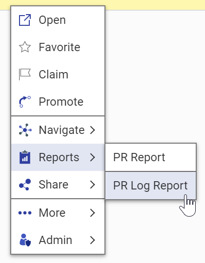

ECR Log Report

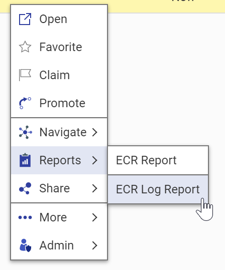

You can get quick information about all the ECRs submitted to Aras Innovator with the ECR Log Report.
Figure 278.
There are several ways to access the ECR Log Report:
  • Go to Contents à Change Management à ECRs, right-click any ECR, and then click Reports à ECR Log Report.
Figure 279.
  • Open the view of any ECR. On the ECR toolbar, click Reports, and then click ECR Log Report.
Figure 280.
At the top left corner of the ECR Log Report view, there is a Print button, which uses the standard browser print function. Depending on the browser and your specific configuration, various print choices, such as printing to a printer or saving to PDF, are available.

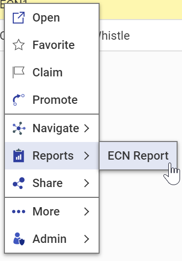

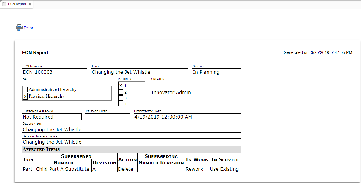

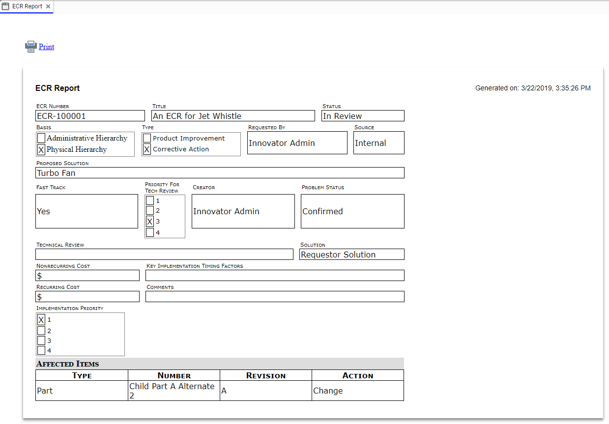

ECR Report
You can print or share an ECR using the ECR Report.
Figure 281.
There are several ways to access the ECR Report:
  • Go to Contents à Change Management à ECRs, right-click an ECR to be reported, and then click Reports à ECR Report.
Figure 282.
  • Open the view of an ECR. On the ECR toolbar, click Reports, and then click ECR Report.
Figure 283.
At the top left corner of the ECR Report view, there is a Print button, which uses the standard browser print function. Depending on the browser and your specific configuration, various print choices, such as printing to a printer or saving to PDF, are available.

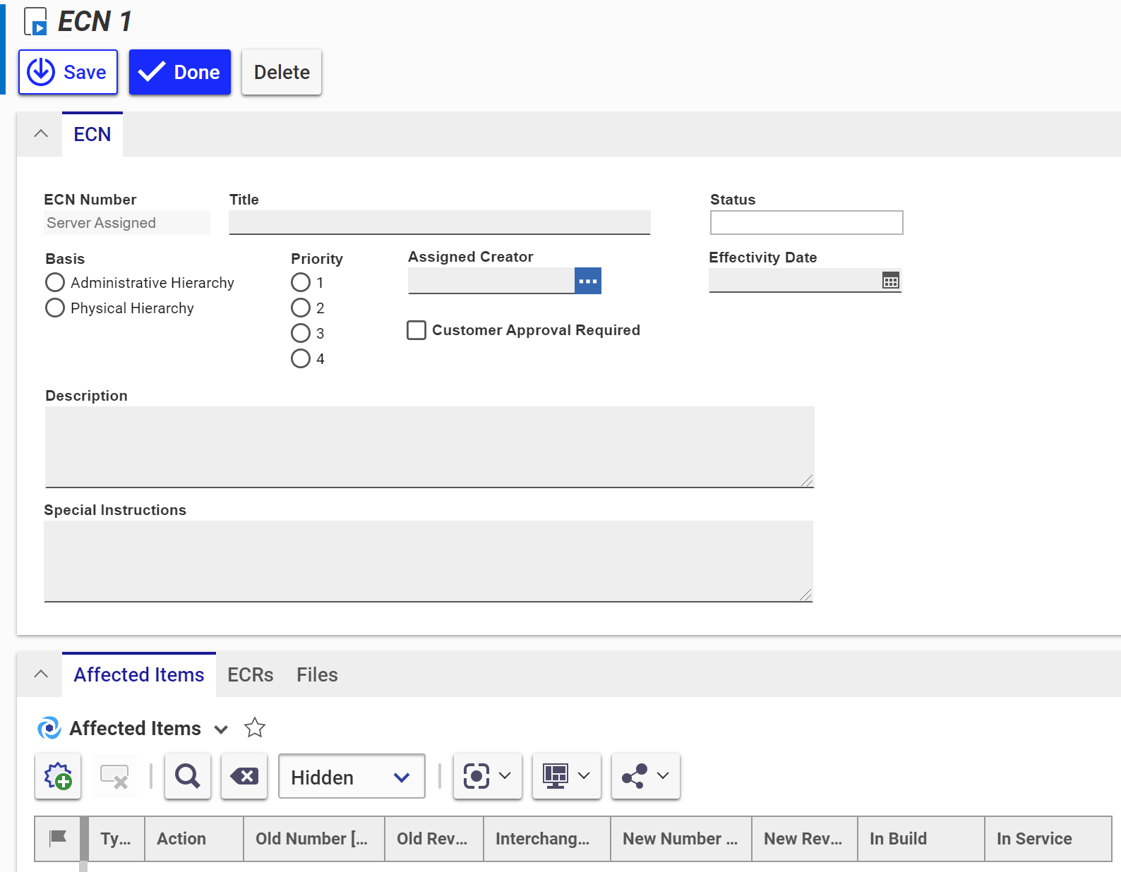

Engineering Change Notice (ECN)
An Engineering Change Notice (ECN) is a process for implementing changes within an organization.
There are three types of change Actions for an affected Item in the ECN process:
  • Add — A new affected Item becomes Released.
  • Change — An affected existing Item is modified. The Item becomes Superseded, Obsolete, or incremented to a new revision level to allow modification.
  • Delete — An existing affected Item is obsolete. The Item becomes Superseded or Obsolete.
Understanding the ECN Process
The ECN workflow has the following roles:
  • An ECN Creator is the user who initially created the ECN in the system. This may or may not be the same person as other roles.
  • An ECN Owner (Assigned Creator), is the engineer or technical person responsible for the technical implications of the change and its ramifications.
  • A Change Specialist II (CSII) prepares ECNs for implementing approved ECRs as well as the ECN impact information for the change review board to develop a detailed implementation plan.
  • A Change Specialist III (CSIII) audits the ECN implementation using ECNs and detailed implementation plans as checklists.
  • The Configuration Management (CM) group.
An ECN traverses between various states during its life cycle depicted in the following figure.
=Figure 284.
The ECN workflow together with the ECN life cycle produces the following scenario:
Figure 285.
  1. A member of the CM group creates and submits the ECN.
  1. The ECN enters the ECN Planning activity assigned to the CSII. According to the company’s rules and policies, the CSII reviews the ECN, assigns an Owner to it, and makes decisions and recommendations about the propagation of the Item change. For example, the CSII can decide whether a part should have a new revision or an entirely new part number. Also, the CSII checks whether a changed part leads to a change of revision or part number of assemblies containing this part. Once the CSII votes Complete, the ECN moves further.
  2. The ECN enters the Update Documents activity assigned to the Owner. The Owner is responsible for updating the Item documentation affected by this change, including BOMs, specifications, drawings, and any other documents. The affected Items requiring the change of documentation may include only the items being changed directly but also hierarchies containing these Items. Once the Owner votes Complete, the ECN moves further.
  3. The ECN enters the Review Documents activity assigned to the CSII. The CSII decides to either:
  1. Reject — The ECN goes back to the Update Documents activity.
  2. Approve — The ECN goes further.
  1. The ECN enters the ECN Audit activity assigned to the CSIII. Once the CSIII votes Complete, the ECR goes further.
  2. The ECN becomes Released. The life cycle states of the affected Items are automatically updated.

Creating an ECN
Because an ECN can be used to add, change, or delete affected Items, the ECN creation process can be conventionally divided into general and specific procedures. This section defines the general steps a member of the CM group should use for creating an ECN. The specific procedures are outlined in sections Adding an Item with an ECN, Changing Items with an ECN and Deleting an Item with an ECN.
To create an Engineering Change Notice:
  1. Go to Contents à Change Management à ECNs.
  1. Click Create New ECN. The view of a new ECN appears.
Figure 286.
  1. Enter the ECN title In the Title text box, making it as descriptive as possible.
  2. Select the appropriate hierarchy for Basis:
  • Administrative hierarchy refers to anything related to the process of running the business. An error in an expense report procedure would be classified as an administrative hierarchy.
  • Physical hierarchy refers to the Item (Part) itself and any Document associated with it. A bug in software would be classified as a physical hierarchy.
  1. Specify the change priority number in the Priority field. The higher the priority of the change, the lower the number selected.
  2. Specify the ECN Owner in the Assigned Creator text box.
  3. Specify the date on which the ECN goes into effect in the Effective Date box. If left blank, it is automatically set to the Item release date.
  4. If the change requires customer approval, select the Customer Approval Required check box.
  5. Describe the change in the Description text box.
  6. If there are any special instructions for the change, enter them in the Special Instructions text box.

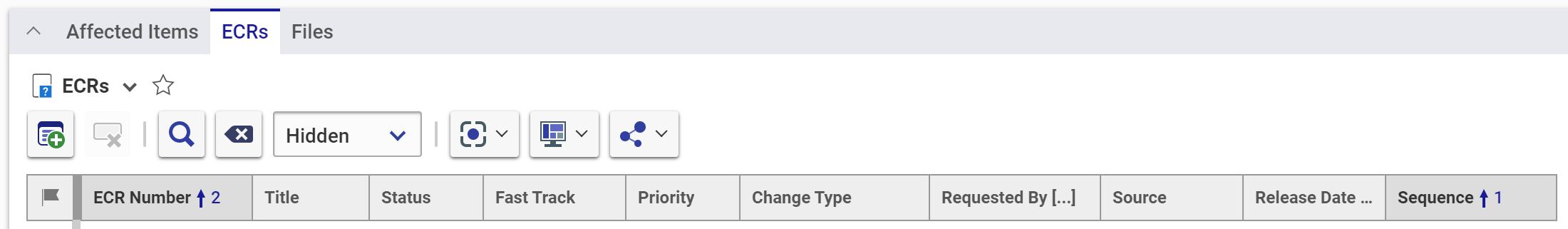

  7. Go to the ECRs accordion tab to attach all the ECRs included in this ECN for tracking and reporting.
Graphical user interface, application, table
Figure 287.
  1. Click Add ECRs on the ECRs accordion toolbar. The Search dialog – ECR appears.
  2. Search for and select the ECRs combined or included in this ECN. The selected ECRs appear as new rows at the bottom of the ECRs grid.

  1. Go to the Files accordion tab to attach all the files concerning this ECN.
Figure 289.
Figure 290.
Note: Aras Innovator will automatically assign a file type depending on File’s extension when you save the ECN.

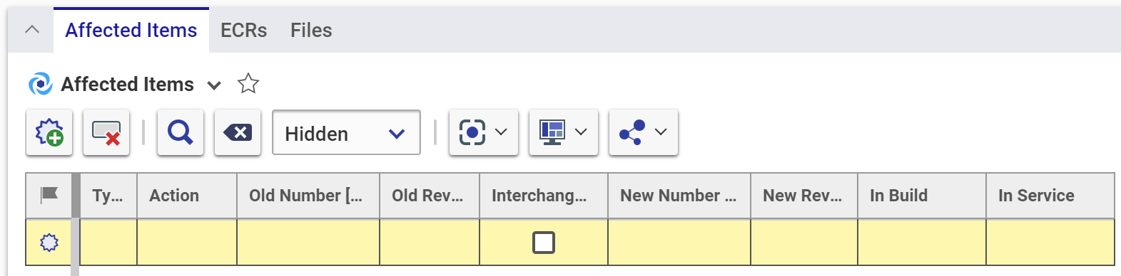

Because an ECN can be used to add, change, or delete affected Items, the ECN creation process can be conventionally divided into general and specific procedures. This section defines the steps a member of the CM group should use for adding affected Items when creating the ECN. Section Creating an ECN outlines the general procedure. The other specific procedures are outlined in sections Changing Items within an ECN and Deleting an Item within an ECN. A new Item has the Preliminary State. An ECN promotes the Item to the Released State at the end of the ECN process when it is released.
To assign a new affected Item to release with an Engineering Change Notice:
  1. Open the ECN.
  1. Click Edit on the ECN toolbar.
  3. Click Create Item on the Affected Items accordion toolbar. A new row appears at the bottom of the Affected Items grid.
Figure 292.
Figure 293.
Figure 294.
  1. Click Save or Done on the ECN toolbar. The ECN has an affected Item assigned for adding.
Because an ECN can be used to add, change, or delete affected Items, the ECN creation process can be conventionally divided into general and specific procedures. This section defines the steps a member of the CM group should use for changing affected Items when creating the ECN. Section Creating an ECN outlines the general procedure. The other specific procedures are outlined in sections Adding an Item with an ECN and Deleting an Item with an ECN. A change for an already Released Item can be either
  • Interchangeable, the Released Item is automatically revised during the ECN process to create a new Preliminary Item version to keep changes. When the ECN is released at the end of the ECN process, this new Item version is Released.
  • Non-Interchangeable, During the ECN process, any necessary changes are made to a new Preliminary Item. When the ECN is released at the of the ECN process, the new Item is Released, and the old affected Item is Superseded.
To assign an existing affected Item to be changed when creating an Engineering Change Notice:
  1. Follow steps 1-4 of the Adding an Item within an ECN procedure.
  1. Select Change in the Action cell.
Figure 295.
  2. Search for and select the affected Item to be changed. The selected affected Item populates the Old Number cell.
Figure 296.
  1. Select the Interchangeable cell check box if the old and new Items are interchangeable, e.g., if there is no Fit-Form-Function change. The new Item version can be replaced or modified without causing any change in functionality to the surrounding Items. When selected, the same Item number will be retained.
  2. If the Interchangeable cell is not selected, e.g., the old and new Items are not interchangeable due to a Fit-Form-Function change, select the replacement new Item:
  2. Using the standard search procedure, search for and select the new affected Item. The new affected Item populates the New Number cell. This new item must be in the Preliminary state to pass readiness checks during the ECN process.
Figure 297.
  1. Click Save two times on the ECN toolbar.
  2. Select the action to take on the Items that are being built in the In Build cell: Use Existing, Rework, or Scrap.
  3. Select the action to take on the Items that are currently in service in the In Service cell: Use Existing, Rework, or Scrap.
Figure 298.
  1. Click Save or Done on the ECN toolbar. The ECN has an affected Item assigned for changing.
Figure 299.

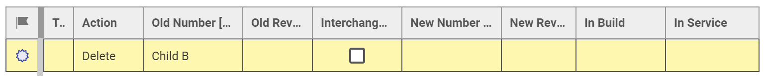

Because an ECN can be used to add, change, or delete affected Items, the ECN creating process can be conventionally divided into general and specific procedures. This section defines the steps a member of the CM group should use for superseding affected Items with the ECN. Section Creating an ECN outlines the general procedure. The other specific procedures are outlined in sections Adding an Item with an ECN and Changing Items with an ECN. An already Released item gets Superseded at the end of the ECN process when it is released.
Use the following procedure to assign an existing affected Item to be superseded with an Engineering Change Notice:
  1. Select Delete in the Action cell.
Figure 300.
  2. Search for and select the affected Item to be deleted. The selected affected Item populates the Old Number cell.
Figure 301.
Figure 302.
  1. Click Save or Done on the ECN toolbar. The ECN has an affected Item assigned for superseding.
Figure 303.

Submitting an ECN
Use the following procedure:
  1. Go to Contents à My Innovator --> My InBasket à Search My InBasket.
  1. Double-click on the Workflow Task to open the Workflow Activity Completion dialog for the ECN.
Figure 305.
  3. Click Complete.
The ECR enters the ECN Planning activity assigned to the CSII.

The ECN Report
You can print or share an ECN using the ECN Report.
Figure 306.
There are several ways to access the ECN Report:
  • Go to Contents à Change Management à ECNs à Search ECNs, right-click an ECN to be reported, and then click ECN Report.
Figure 307.
  • Open the view of an ECN to be reported. On the ECN toolbar, click Reports, and then click ECN Report.
Figure 308.
At the top left corner of the ECN Report view, there is a Print button, which uses the standard browser print function. Depending on the browser and your specific configuration, various print choices, such as printing to a printer or saving to PDF, are available.
