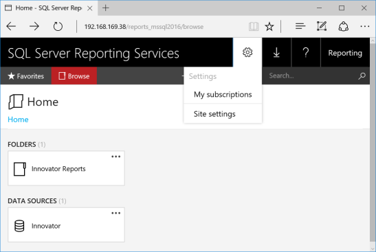

Click the Site Settings link in the upper right-hand corner of the Report Manager page.
Figure 24.

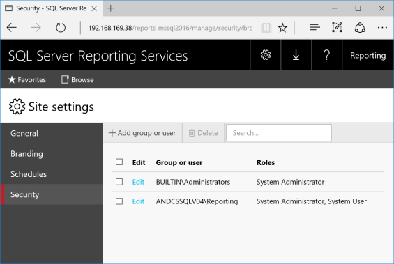

Click the Security tab.
Figure 25.
Click Add group or user to map the Reporting User Account as a Reporting Services Role.
Figure 26.

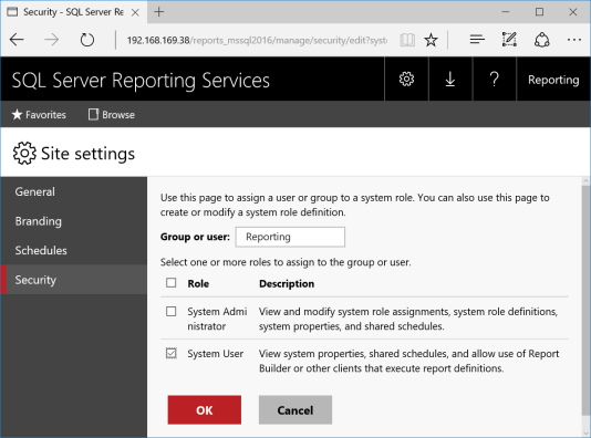

Enter the Reporting User Account name, select the System checkbox, and click OK to create the new Role.
Figure 27.

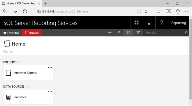

Click the Browse link in the upper left corner of the page.
Figure 28.

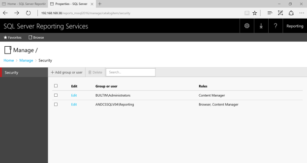

Click the Manage Folder link.
Figure 29.
In the settings tab, click Add group or user.
Figure 30.

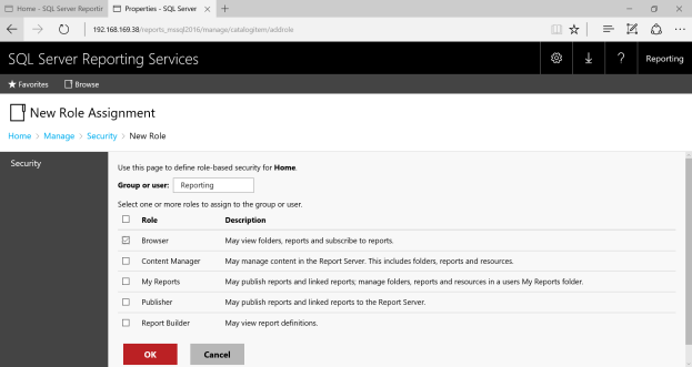

Enter Reporting in the Group or user field, select the Browser checkbox, and click OK to create a new Role Assignment for the Innovator Reports folder.
Figure 31.
