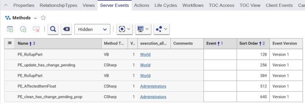

Server Events
The purpose of Server Event Methods is to perform some custom actions either before (OnBeforeXXX) or after (OnAfterXXX) a particular server action (like add, delete, etc.) or fully replace the action processing on server (OnXXX).  Detailed information about Aras Innovator server events can be found in section Available Server Events.
The following Server Events are currently available in Aras Innovator.  Each of the following events is followed by a short description and an example of common use.
