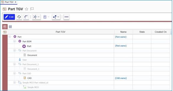

  1. Double-click in the Part-Name cell and specify the following:
    1. Cell View Type: Text
    2. Text Template: {Part.name}
  2. Figure 10.
    Note: Because there is a recursive structure, the Child Part cell also gets the same mapping.

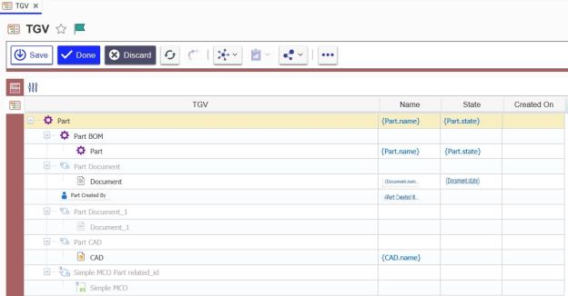

  1. Double-click the CAD Name and Document Name cells and specify the name properties for both.
Figure 11.

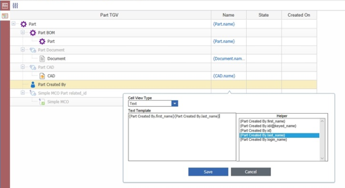

  1. Double-click the Part Created By Name cell and set the Text Template as {Part Created By.first_name}{Part Created By.last_name}.
Figure 12.

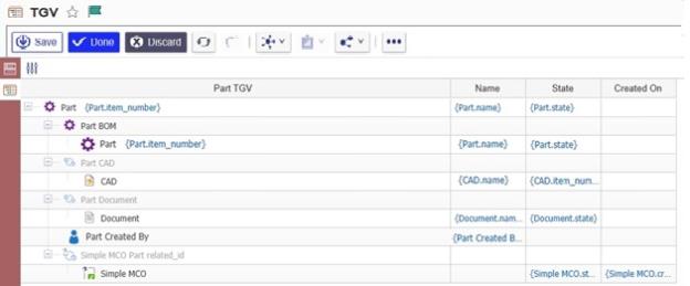

  1. Map the State properties for Part, CAD, Document, and Simple MCO to the appropriate cells.
Figure 13.

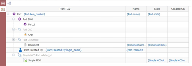

  1. Repeat the previous steps to create the same link for Part Created By Part TGV cell, but for text display select the login_name property.
Figure 17.

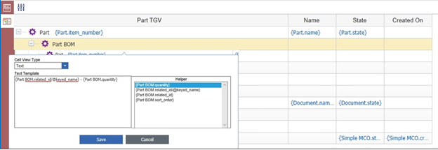

  1. Double-click into the Part BOM-Part TGV cell and set the following: {BOM.related_id/@keyed_name} - Qty: {BOM.quantity}.
Figure 18.
