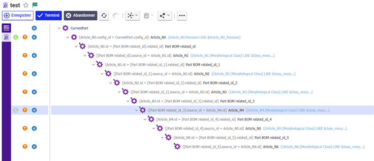

Hello, in a query definition, I use the use case of an article to bring up its parent articles.
I would like to be able to filter any level from the $class_morpho parameter which corresponds to [Morphological class].
At each node I defined a condition.
But as soon as it looks for a specific morphological class, it looks at the first level of kinship and if the value does not match and displays nothing while at the last level the value exists.

  • Hello and thank you Angela, yes I know this "Reuse Query definition" function it's the method I used initially, but I couldn't display only the "morphological class" of the last level parent articles. So I tried to make a more detailed structure and create a parameter per level "[Morphological class] like $class_morpho_N1 for level 1, [Morphological class] like $class_morpho_N2 for level 2 etc. To do a selective search by level, this solution is not necessarily the easiest. The goal of my query is to be able to make like excel a filter on a column and to display only the chosen value, and I don't want to export excel but use aras in all its features. The ideal function would be not to put a filter in the query to retrieve all the articles but to be able to activate a filter in the tree grid view as in a search of the main article grid, and I don't know how to do it yet. Thank for your help.
