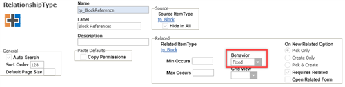

    This functionality is controlled by the Behavior of the relationship. By default, all relationships are created with a behavior of Float which means that the related item of a relationship will always point to the most current version of that item. However, you can change this behavior to be Fixed which means that it will always point to the same version of the item as when the relationship was created.
