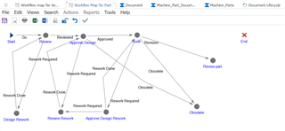

The Workflow of 'Parts' can be defined as follow:

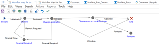

The Workflow of Documents is represented as follow:

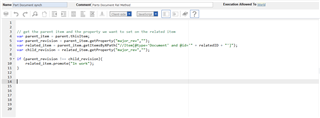

    I tried coding the method as you said. I wrote it for the relationship Parts-Document. Basically if I do a revision of my part i want to promote my document back to 'In work' in order to trigger the workflow.
    I wrote following method:
    I assigned it in the RelationshipType Parts_Document and selected 'OnSelectRow'.

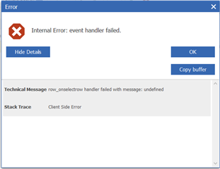

    However, I get following error message every time I click on the document in my Parts form:
    Do you have any idea where that comes from?
