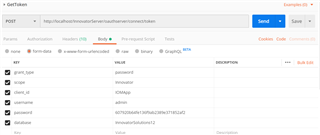

Could spend some time on this and found useful link below.
https://community.aras.com/b/english/posts/token-authentication-using-the-rest-api

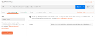

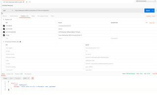

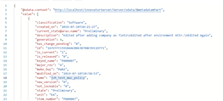

Follow this link and retrieve bearer token. If you use this bearer token things are working fine for me.
Here are snapshots from Postman
Let me know if this helps
