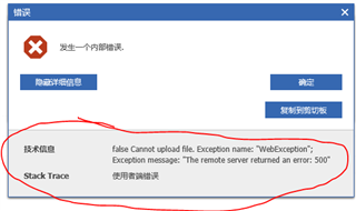

Hi AJ,
Exactly, you get what I am doing through the code. For your concern, I did put a correct file in the location C:/temp/{filename}. However still pop up the vault URL error. Thanks.

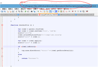

Your use case is strange to me, but I guess that should work. I've got a few more things to test.
Could you isolate only the uploading code? Hard code in a file path which you know exists and verify that you can upload a file using a single use method. Remove anything except the code between the file item declaration and the apply statement.
Could you also ensure that you've got the file you're looking for on your client machine as opposed to the server? If you're running locally this won't be an issue but It's just something that's good to check.

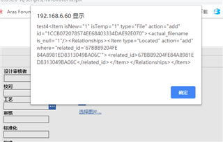

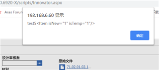

Hey AJ,
As you suggest, I did isolate the uploading code, as the code located at C:\Program Files (x86)\Aras\Innovator\Innovator\Client\scripts\manageFileDialog.html
And there is no luck still pops up the same error, Please see the screenshots below, I also put the alert message for testing purpose for your reference. Thanks for your time AJ!
