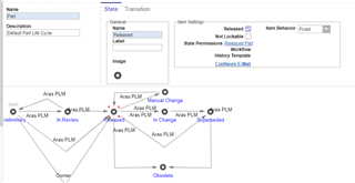

This can be achieved by modifying the life cycle of the process plan ItemType. Below is an example of the lifecycle for part, and you can do something similair to the process plan.
Basically on the "released" state you'll have to add a new permissions set to the "state permissions" property. This should accomplish what you're looking for.

Thanks AJ Sebastian for your valuable comments. You came up with an answer of what i'm looking for.!
