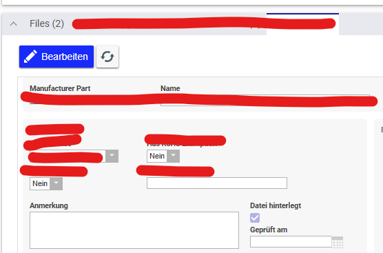

    Maybe some idea for you to copy. Make your own buttons!
    I used aras.uiShowItemInFrameEx to get the target form and added a custom "Edit","Save","Abort" and "Refresh" button by myself:
  • オフライン in reply to AngelaIp
    Looks great!  I just found that if the view is set as 'edit' that it'll work for the use-case I want (making it editable), though it's not a total solution as still need to trigger some of the other default behaviors and such.
