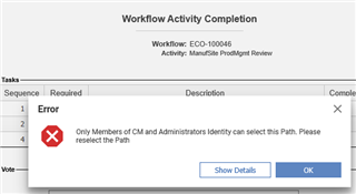

  • Hi Mikael
    I tested your scenario and able to block user from vote. Can you check below case
    1. Is this user member of CM / Administrator identity ?
    2. Is this user member of any identity which is member of CM / Administrator identity ?
    Example : user is member Group A and Group A is member of Administrator
    3. Is the ID configured for CM and Administrator identity correct ?
    4. If so, then can you debug this method and check ?
    if (System.Diagnostics.Debugger.Launch()) System.Diagnostics.Debugger.Break();

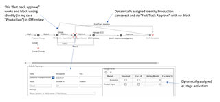

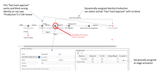

  • Hi Gopikrishnan,
    Still not working for the specific stage, in my case this stage is dynamically assigned, so  on create ECO user selects from a drop down list the Groups (identities) to be assigned, then a method checks that and set these identities as assigned (this assign method works really good).
    However, if I on another stage add a "fast track approve", have assignee's directly in that stage (no method to add them), then your code blocks the user to go that path if not correct identity
    So your code works, it is somehow related to the dynamically assigned identities.
    My workflow and Dynamically assigned Stage when it has become activated looks like this
