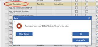

The last question is I try to copy the mpp_Operation as you suggested and it pops up the error as screenshot below, do not have an idea about this. Appreciate it!
