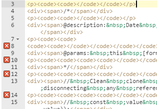

I can't figure this out. I simply want a ... ceiling on a calendar input value.What is happening to this? I can take the same passed value and do the same operation in Chrome dev tools and it works perfectly as expected.
What is Innovator doing here? It logs the inputTime, as a number, and I can take the same value and pass it to the same formatting function outside of this onChange listener function.

^^^^^End code, but you wouldn't know because this editor is as unfriendly as the code editor. Who wants to tab from the title to the print button!? Why would you have tabIndexes on your main form inputs like 128 and 256!? Everything about this thing takes extra time. Goodness gracious. Aras Innovator is going to kill me.
