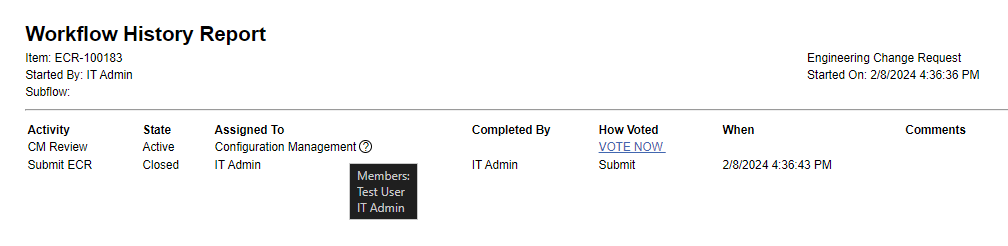

Hi Nathan and anyone else looking for a similar solution,
I personally don't like displaying the OOTB identities form to users, as an alternative I modified the SignOffs tab to provide a list of members in the identity group on mouse hover as well as add a ? icon to groups to indicate that hovering provides more information:
(Btw my version of Aras is V12SP18 so millage may vary if this works for you in a later/earlier version)
Similar to Angelalp's blog on editing the signoff report I added the following to the "Stylesheet" section of the "Workflow Process History" Report ItemType:
In the <style> section of the stylesheet I added the following CSS class to create the circle around the "?"
