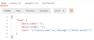

    If my method is like this:
    var item = this.getInnovator().newItem();
    item.setProperty("json", new Newtonsoft.Json.Linq.JObject
    {"return_code", 0} ,
    {"message", "hello world!"}
    }.ToString(Newtonsoft.Json.Formatting.None));
    return item;
    The output is a text:
    So, you are right, with your solution the output is well a JSON.
    But a JSON of an Item. Is it possible to send a fully customized JSON ?
    Regards.
  • Hi Miraks,
    standard Aras Method just can return items. "Results" and "Error" are also just items.
    Maybe you can use some kind of custom class or other more native C# techniques, but I am not sure. Some times you see these kind of designs in native Aras code.
