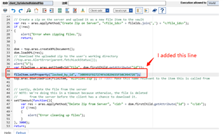

Hi All,

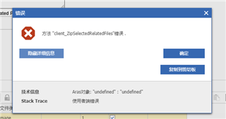

I have an issue about client_ZipSelectedRelatedFiles method that I got from Aras GitHub lab which is useful for mutiple download functionality,once  I added a line " fileItem.setProperty("locked_by_id", "30B991F927274FA3829655F50C99472E");" then It pops up error that said ARAS object:"undefined" which confused me, any ideas? Thanks!

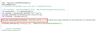

  • 0 オフライン in reply to AngelaIp
    Hi Angelalp,
    I did updated the a piece of code as you suggested, using regular get queries instead of getItemById.
    it looks fine until the code runs to the red line I marked which downloading files as Zip file then shows the same error again. Is that "fileItem" should  not be a item object or something else? Appreciate it.
    Hey Angelalp,
    the code should works.
    var fileItem = aras.getItemById("File", dom.firstChild.getAttribute("id"));
    aras.downloadFile(fileItem, zipFileName + ".zip");
    What I am trying to do is locking the file before downloading it, so the other users will not download it  until the I upload this file is done. If like you said the " File " Item is no that kind of locked/unlocked properties, so any suggestions that how to blcok others from downloading action if there is already has a user just did download action and not done with the upload?  Thanks very much Angelalp.
    Angelalp, it is so odd that I got the File's Parent item which is "Document" Item,and then i trying to set that Document locked,  in that case it still throw the error as long as i use setProperty() function, it seems that the error happened everytime once i use "setProperty()..."
