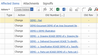

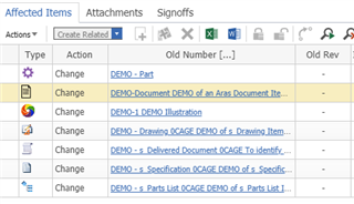

    I was preparing a Simple ECO and my sm_Change ItemType to verify the problem and create images when I noticed that the Simple ECO Affected Items displays the Icons for each ItemType, but the sm_Change Affected Items does not.  This is making me think that there is something else that pulls the image into the Affected Item.
    Looking at Affected Item ItemType the Type property is Federated.  I'm not sure exactly how that is supposed to work.  Looking at the Property form, there isn't an event attached to the property.
  • "Federated" properties are always empty and filled programmatically by Methods on demand.
    There are "Server Methods" in Affected Item, but I don´t think they are responsable for the icon. You will probably need a Server Method in the Relationship.
    Edit: Method 'PE_PopulateAffectedType' looks like the solution. See how it is used in standard Aras and just rebuild.
