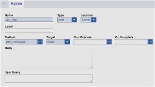

Hi All,
I have Multiple Server Side Item Actions Configured on the Part Item , I want the logic/functionality to be performed by each action to be controlled by the same method .
In which case , is there a way to pass the Invoking action name to the Method so that based on the value I can chose the function to be performed.
For the above action , I want to get the action name "plm_Test" while invoking the method on the Item.
This would greatly help me in avoiding creating Multiple Methods for each Action.
Thanks.

  • CUI is the choice of the real professional!ThumbsupSlight smile
    Haven´t tried this one with CUI so far, so your inArgs hint is also useful for myself. Not sure if I was really right with my Action solution. I think I mixed it up with a different issue. I checked my Actions again -> in reality I used small Methods that call the main Method with "dummy" property to indicate the calling Action. Your CUI solution is more elegant.
