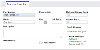

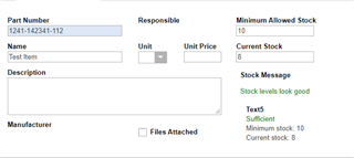

The problem is that it works for a little bit, and then the evaluation does not reflect the correct values.
Some examples:
Any ideas?

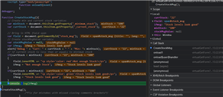

    Thanks for the quick reply.
    The function only evaluates the two fields and displays a message when the item is opened. The only time when the values might change is when a user or future feature, changes it.
    I added an ifmsg variable to show which is triggered more easily.
    Here is an image of the debugger.
  • Are your fields "string" or "integer" properties? According to your debugger, they look like strings! In this case greater and less may calculate based on wrong values.
    Try to parse the value  -->
    parseInt(minStock, 10)
    And maybe use an onFormPopulated event instead of onLoad, when the fields shall also update when user edit the item.
    Ahh, that was it, thanks!
    The properties for those values are set to integer, but it's fine now.
