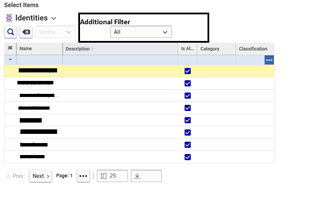

I have a Search Dialog opening on an Item Property (e.g Identity)
As shown in the below Image I wish to further filter the results based on an Addition Parameter provided by the User via CUI Drop down box, I am trying to figure out a way to repopulate the Search Dialog on Change of the Additional Filter Criteria.
P.S. The Additional Filter Property may be a relationship attribute based on which the user wants to filter the Parent Items.

    interesting use case. Which version of Innovator do you use? When I tested out CUI dropdowns last year, there weren´t much samples available and the dropdown was hard use. Not sure if they are easier to use now.
    Have you checked if you could achieve your behavior already with a regular custom "Search Mode"? You can extend the "Simple", "Advantaged" search modes with a custom one.
