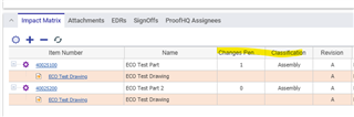

Aside from adding the relevant lines to the  Express ECO ImpactMatrixGrid, is there something else I need to edit to add the columns? My new column is appearing as undefined.

    Thanks Angela, I've got it configured with these items and I can now view the column and the name however it is not populating the value.
    I am looking to add the has_change_pending property, which I have added to Change Controlled Item for the purpose of populating the impact matrix (this missing on the item type was causing the undefined).
    Currently, it is always showing blank so that is the next thing I am trying to solve. I am assuming I need to setup my cell class to show a specific value if true so will do that and report back.

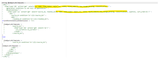

    I got it working. I had to update 'Express ECO GetDataSource' as well to account for the additional property - here specifically, beginning at line 128 -
    String itemQueryAMLTemplate =
    "<AML>" +
    " <Item type='{0}' action='get' select='id, name, item_number, major_rev, state, keyed_name{3}, has_change_pending'>" +
    " <generation condition='is not null'>%</generation>" +
    " <Relationships>" +
    " <Item type='{1}' action='get' select='source_id, related_id(id, name, item_number, major_rev, state, keyed_name{4}), quantity, sort_order{5}'>" +
    " <OR>" +
    " <source_id condition='in'>{2}</source_id>" +
    " <AND>" +
    " <related_id condition='in'>{2}</related_id>";
    I added the has_change_pending property to the aml.
    Now it shows the values - 1 or 0 for the bool, just need to modify the return statements I believe to reflect more user friendly text.
    Success, however now for some reason there is some odd behavior. My columns are there but values are only populating for Part...
    And when adding a sub-assembly, it only populates for the the item I add, and it's parent...
    When I set an action on an item these populate as well.... unless the item in question is a CAD Document

    Got this resolved too. Had to edit 'Express ECO GetDataSource' again -
    At line 266, add properties here as well:
    String notRequestedItemsAmlTempalte =
    "<AML>" +
    "  <Item type='{0}' action='get' select='id, name, item_number, major_rev, state, keyed_name{2}, has_change_pending, classification' levels='0' >" +
    "    <id condition='in'>{1}</id>" +
    "  </Item>" +
    "</AML>";
