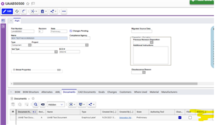

    The next step I need is for all of these parts, let's take UAAB50500, if there is a Document related to it via Part Document, I need that document ECO to update as well:
    Lastly, the model for this part needs to be updated to include the ECO number.
