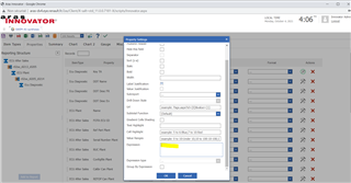

Example : I've an property on ITEM1 : Prop1 = "Val1"
I would like to display in selservice report the value for Prop1 = X_Val1
Can I use Expression or other solution to avoid calculate on dedicated property ?
Learn how to get a better understanding of the Aras Report Service with this one weird trick:
--> When using this report service, better follow the guidelines of the original manufacturer:
https://wiki.izenda.us/Guides/ReportDesign/15.0-Expressions-in-Izenda
See:
We can also use expressions to manipulate text. Let’s say that we have 'ShipCity' (e.g. Berlin), as well as 'ShipCountry' (e.g. Germany).
Using the following expression:
[ShipCity] + ', ' + [ShipCountry]
See:
:-) , Thanks a lot.
it is exactly what I wanted.
It works fine
