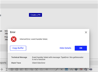

The error message is: The method 'create_PR_from_tgv' failed. Innovator is not defined Client Side Error

    My suggestion: Do like Aras do. They most of the time use: var inn = this.getInnovator(); in JS Methods. Maybe check some existing Methods how Aras calls the Innovator object.
    In addition, don´t use top.aras. Top is deprecated since many versions. In the past it most of the time didn´t make any trouble, but maybe today it will.
    Thanks , that command gives the same error.  We've opened up a bug report on this one with Aras as we've tried just about every variation of it from the Programmer's guide and nothing seems to be working.  OOTB methods don't see to have something exactly the same, but those that have similar commands seem to be referring to the same commands, so stumped on this..
