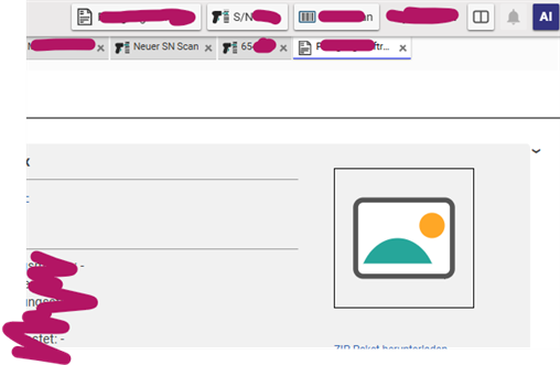

    Regarding pinning TOC-Views: In my case I had a couple of TOC views that were only relevant for a very specific group of people. So I simple "pinnend" the 3 relevant TOC views for this specific group identity to the top header. Technically it´s CUI elements that open a TOC view.
    The custom CUI variant has few advantages and extra features. User can open the same TOC view multiple times. The tab label can be overwritten by the context item to avoid confusion. And TOC views can interact which each other.
    If any of the latest releases introduced a "CUI location" for the favorites sidebar, we could use the same button elements in the sidebar already. But I haven´t checked this yet. In my version the sidebar is still code generated.
