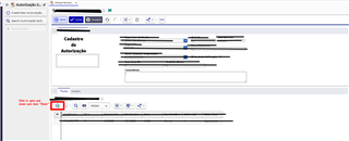

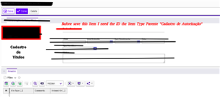

  • 0 オフライン in reply to AngelaIp
    Hello, I have two forms one to insert new "Authorization" this below picture, and when I click in the in the button plus the new form is opened, to insert the new "AuthorizationTittle" second picture, and the issue is that I need the Authorization ID before save the AuthorizationTittle, second form.
    Thanks.

    I tried something like this, in the before and after add in AuthorizationTittle, but the issue is that the RelationshipItemType is filled only in the save of the Authorization(parent) form.
    It's a big issue.
    Thanks.
