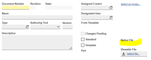

    Before Change
    Using Below Code (Entire element will be disabled)
    const displayName = document.getElementsByName('native_file')[0];
    if(somecondition)
    displayName.style.display = 'none';
    else
    displayName.style.display = 'inline';
    Using Below Code (Label will display but only upload will be hidden)
    const fileItem = document.getElementsByName('native_file')[1];
    if(somecondition)
    fileItem.style.display = 'none';
    else
    fileItem.style.display = 'inline';

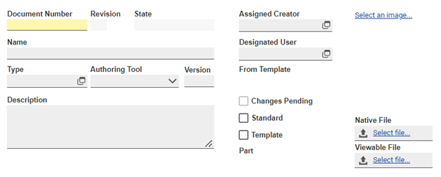

    Before Change

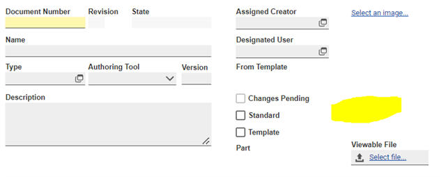

    if(somecondition)
    else
    if(somecondition)
    else
