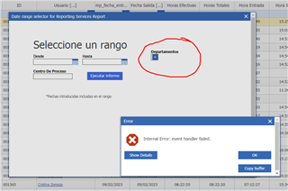

Well, there's no way, I've looked at examples here, in google, and in... chatgpt. But it always fails me when executing the code, it always gives me the error:
Event handler failed with message: TypeError: Cannot read properties of null(reading 'appendChild')[function onload$user$handler(e) {

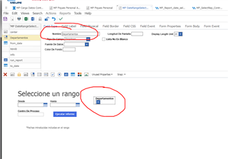

This is the structure of where the field is:
All the code is executed when entering the form, in the event "onLoad"
