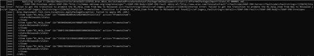

I am working on importing custom itemtypes to load via AML package as part of new builds. Due to how a customized contextual window displays these items, I need the items to be in a 'Released' state when they are brought in. (The window will only display 'Released' items).
However, I am having difficulties getting the items to be in a 'Released state'
1. I've tried adding a <state>Released</state> to each item being brought in
2. I've tried adding a postAMLpackagedeployment script that adds a <state>Released</state> to each item
The catch is, I need the items to abide by its lifecycle/workflow normally when edited and the state returns to 'New'.
Is this possible?
Parents Reply
  • 0 オフライン in reply to Jayraj Hogade
      I'm getting a "failed to get the transition to promote the Item from New to Released error:
    Previously, there was no direct transition from New to Released. Do I need to add a transition (with the Aras PLM identity) to make this possible?
    EDIT: I've added a transition from the New to Released state (with the Aras PLM identity) and I'm still getting the same error
    EDIT2: I've also tried moving the item to the very next state (transition handled by a non-admin identity) and also got the same error
