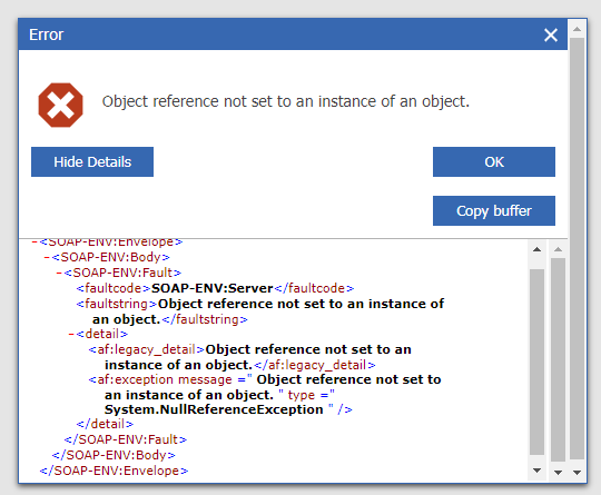

    The funny thing is that it executes all the code and then gives me the error message.

    In the line 9 i have a getItemCount, but before it shows me the message, it has already executed all the code, it has created the RM and that's how it shows me the message. The bad thing is that since I created the RM before, it always tells me that there is already an RM for that code.
    I have tried to put all the code after the if in an else. And what it does is that it executes the else and then what is in the if. I don't make sense of this

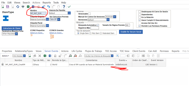

  • 0 オフライン in reply to FernandoCG
    What ItemType is your onBeforeLock event linked to?
  • 0 オフライン in reply to alaxala
    Hello, "MP_MAT_SUM" is the itemtype:
