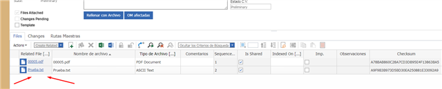

    I try too to load the file object in the itemType "Document":
    But nothing. i dont know how i must to get this as an file object. Sob

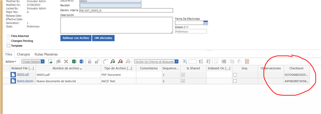

    It is strange, since in the itemtype "Document", there is the checksum attribute, which is in "File" and as foreign in "Document File". The most logical thing, and even more so if there are many users, is that it will control in some way so that duplicate files are not uploaded.
    Right now, in my version of ARAS, when you press the save button "save item", icon of a 3 1/2 floppy disk, from my time, hahaha. ARAS calculates the checksum and saves it. But as I mentioned, he does it in the file "xxhash-asm.min.js", in the line 2, but it is not tabulated and has 132,387 characters, why ARAS???.
    From what I have seen, it does this if a file is added and it is saved, if 2 files are added it does not calculate the checksum, I don't know why!
