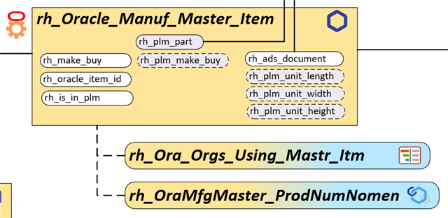

I am trying to "edit"/"update" the properties on a Non-Related Relationship; "rh_OraMfgMaster_ProdNumNomen".
I must be missing something.

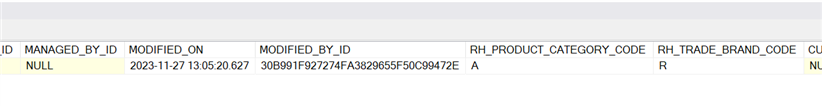

This does not work.
I tried [Item type="rh_OraMfgMaster_ProdNumNomen" action="update"] and that did not work.
