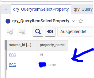

does anyone know how to prevent that Aras use labels for the property selector in the QueryBuilder?
I try to extend a Query Definition, but I would prefer if Innovator shows the native database name of the properties instead of the label:
Note following situation in the image:
- Entries are not distinguishable when they have the same label, like "Document"
- Entries are sometimes just blanks where I have removed the label on purpose
Innovator doesn´t even seem to honor my perfect sort_order of these properties. Does anyone have an idea how to improve the situation? I currently use a pretty old QueryBuilder version. Maybe situation has improved in newer Innovator versions, but I have to work with what I have
