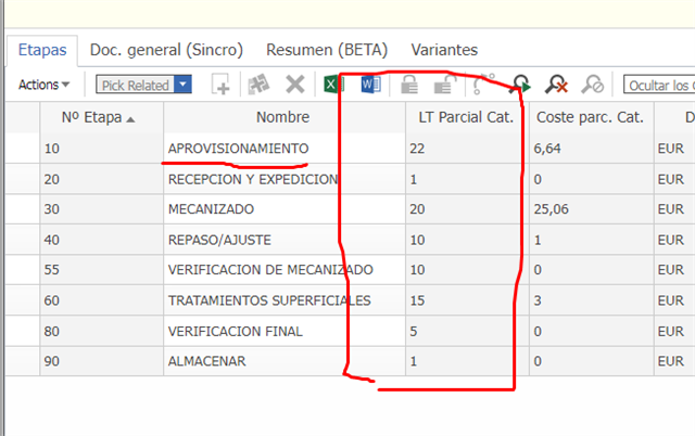

Hello colleagues, I have a problem. I'm trying to do a SQL, select sum(.....). The code doesn't give me an error, but I don't know how to access the value of the variable later.
If you see my code, I have assigned a name to the value received, but when I execute the code, it always gives me "0", which is the value I have entered if there is nothing.

I do it using SQL because it is faster than creating an AML and going through it to add the values.
1.- There is something similar in AML to "select sum"
2.- How can I pass the value of "SQLResult" to a variable to be able to display it on the screen.

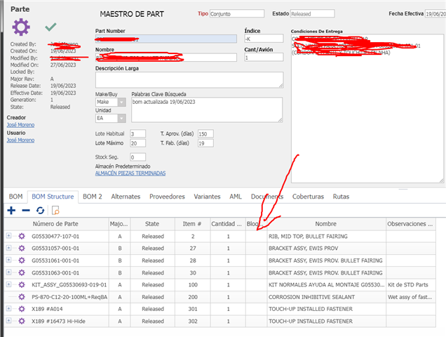

    I have in hand to modify the "PE_GetMultilBom" method. I made a first attempt, but it doesn't show me the value on the screen. I'll put a post in the forum asking for help, hehe.
