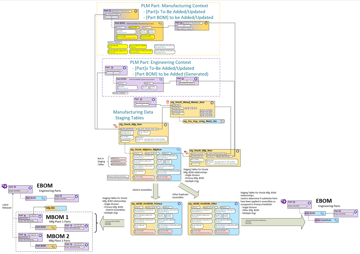

Community,
I have created a staging table capability that will be used to generate innovator eBOMs from Oracle manufacturing BOMs.
My challenge is working with 1.7 million rows of data in SQL Server.
I know I could create a SQL procedure to get the unique (distinct) oracle Assembly IDs but I would like to use a Query Definition.
In the data model below, what is circled in RED is the Oracle Data. What is circled in Blue is where I am separating a
    1) [multi-Division, multi-Ora Org, with non distinct Assemblies (by Ora Org)] : stg_Oracle_MfgItem_MfgItem
     INTO
    2) [single-Division, multi-Ora Org, Distinct Primary Assemblies] stg_eBOM_PartBOM_Primary
     AND
    3) [single-Division, multi-Ora Org, Other Assemblies (without Primary PartBOM)] stg_eBOM_PartBOM_Other
The goal is as follows:
  2) stg_eBOM_PartBOM_Primary will be used to generate the innovator [Part BOM] relationships
  3) stg_eBOM_PartBOM_Other will be compared to stg_eBOM_PartBOM_Primary to derive Substitutes
So I would like to use a Query Definition to gather all the Distinct Oracle Assembly IDs so I can populate the stg_eBOM_PartBOM_Primary table.
Thanks in advance for your time and insight.
Scott

  • Hello Angela,
    Thanks for the Shout out!
    This is a data Migration/Transformation/Loading excercise. A tree Grid View will never be applied.
    The Oracle mBOM Relational Data (structure) will be use to construct PLM eBOMS and PLM mBOMs, then it will be chucked.
    It is being done for 1 division now and will be done for other divisions after the completion of this initial effort.
    I wanted to use a Query Definition based:
    1) Performance
    2) Easily adaptable to other Divisions.
    3) Trying to aviod the use of SQL.
    4) Easier to pass off to the client for re-use.
    The client has implemented mBOMs before eBOMs which will makes this very challenging assignment.
    Here is an updated Data Model.
