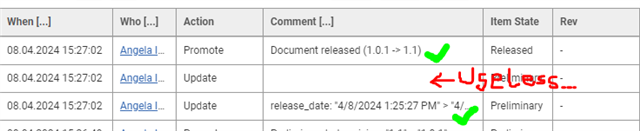

Let´s assume we have an ItemType with History enabled. These track property updates which is ok.
I have a few custom Methods that do something. They write their own history entries with another custom Method. These history entries are more precise than the regular ones by Innovator. So I want to prevent hat Innovator add it´s own history entries, cause they just would spam the history.
