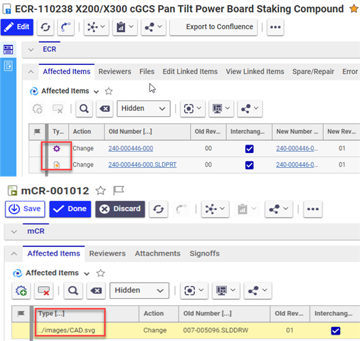

I created a custom itemType for minor changes that is basically like an ECR. The item attaches the affected items in the same manner that the ECR does however I'm unable to figure out why my Type field is not showing the icon.
I've added the PE_PopulateAffectedType method on the mCR Affected Item just like the ECR but it seems like there must be something in some javascript somewhere because I can see that my underlying html is different.
