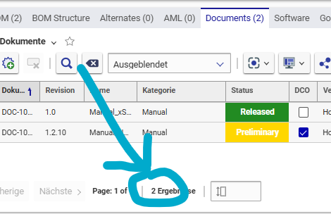

    2. Have the client-side logic that displays the item counts actually perform a count query. The best way to do this would be to set both the page and pagesize to 1 and then look at the itemmax attribute of the returned item to get the full count while limiting the information returned from the database.

  • The code that updates the built in page counter is likely only called once you actually click on the relationships tab, so you'd be better off implementing your own custom logic to get the total item count client side if you decide to go that route.
    And yes, countOnly does work, but at least in my testing of Release 33, it seems that has now been deprecated. You may want to hold onto the idea of of setting page and pagesize to 1 in the event that you upgrade to the newest open release later this year. It works similarly to the countOnly returnMode except that the data you get back can be accessed more easily through the item attributes.
