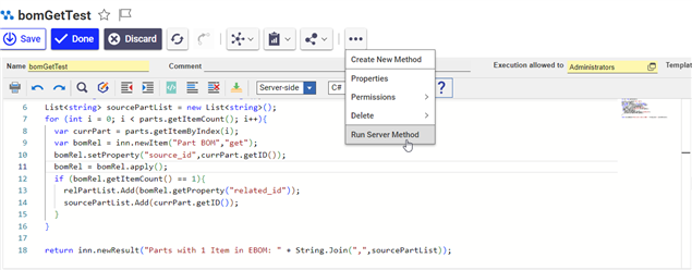

    To utilize this, you can create a new method in Innovator, make sure it's a server method. Then once it's saved you should be able to run the following action (Run Server Method):
    The output should pop up. It'll be a list of IDs for all the parts that have exactly 1 BOM Relationship. After that you should be able to use that list for an AML Query using the idlist attribute.
