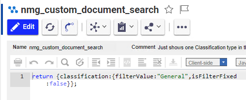

For Documents item type, in the search grid I need the "Classification" to be prefilled to "General" .

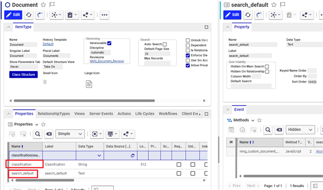

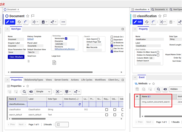

I applied client side method to "classification" and "search_default" properties of Documents but it doesn't work.
"search_default" property did not exist before so I just added it, I don't know if that makes a difference.
method:
return {classification:{filterValue:"General",isFilterFixed:false}};

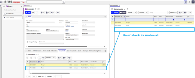

     I applied this method to onBeforeGet. Correct results show in the Document search grid however other Documents, the ones that have Classification other than General do not open. They show but don't open.
    As you can see in the screenshot Document PR-100001 does not show in the search result which is the intended outcome. However, it doesn't open. It would open if the method is not applied to the Document item.

  • To be honest, I don´t thing the onBeforeGet filter is the best solution for your use case at all. I still think MAC and DAC are maybe the better option or just some Saved Searches. Don´t believe everything you find in this forum Grin
    Main question: Do you want to have a restriction out of convenience or for security?
    What you see now is the beauty of all onBeforeGet solutions - the tiny little happy details.
    First you have to ensure that your own identity does not contain the target identity too. If you don´t want to exclude your self from the identity group, write another code to abort the method for admins or similar groups.
    To ensure you can still open the items from a relationship while they are hidden in the main grid, you need a trick.
    Basically you allow people to open the item, if they explicitly search for it (this is what happens in the relationships automatically)
    You need to add something like this to your current solution:
    if (this.getProperty("id","") == "")
       this.setProperty("classification"," Shipping Unit");
    But as mentioned before, it´s maybe not the best solution for you use case. In doubt ask Aras! They get these kind of questions very often. I assume have a subscription. Why not use it?
