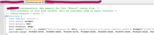

    I once did something similar to integrate the Roboto font support into an early I12. Innovator included the font already but it wasn´t "used" yet.
    You have a "fonts" folder in the codetree where you can add your custom fonts. Than you need to customize the stylesheets to ensure the font is used.
    In my case I only needed to customize common.min.css
    For this mod I have just thrown my custom stylesheet behind the minified code. This ensured the custom code is still some kind of readable.
    If you want to use the font for all Innovator elements you might also need to modify other stylesheets like main.css. Don´t forget to document the codetree mod for upgrade.

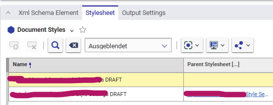

  • Ah I see! I did some research in my "collection of useful things". Maybe this is of help:
    In the DocumentTypes you can specify your own stylesheets:
    It shouldn´t matter if your output is HTML or PDF. You can specify which style sheet to use in "Output Settings".
    Inside your Stylesheet you should be able to specify your external font like this (in this case it was an online Google font which I would not recommend). I have tested the style sheet, but cannot remember if the font worked. It´s 5 years old :).
