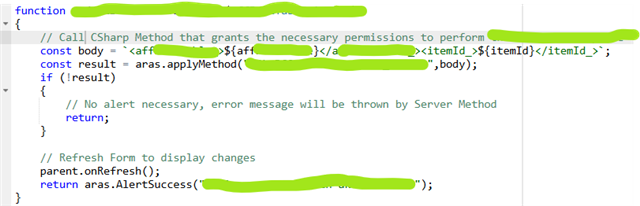

  • It´s also aras.newIOMInnovator() and not aras.IomInnovator;
    And check the browser debugger for error messages.
    In general, always question samples you find on the internet. They are often outdated regarding both Innovator and JavaScript coding style!
    The training area in the subscriber portal has some hidden documents where Aras describes the does and don´ts in modern´ programming in Innovator. E.g. don´t use "top", don´t use "var", ...
    You are not forced to program as if you were still using Innovator 9.4 with Netscape Navigator:
