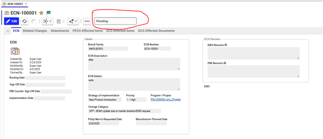

I have added this field here using CUI
Followed by below steps

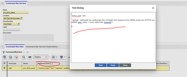

I want to make this field non-editable. I have added this css in Additional Data but t is not working. Please suggest.

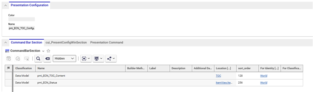

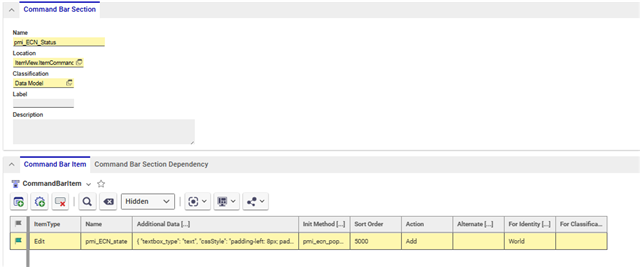

instead of the "Edit" element you could also use a "label" style button element. For buttons { "cui_disabled": "true"} would work. Not sure if it works for "Edits" too, but I would give it a try.
