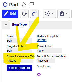

Parameters tab sometimes isn´t loaded when opening a Part. Does anyone know why?
Hi community,
does anyone of you use the classic "Parameters" tab?
It´s a quite old building technique. Technically it was replaced with xProperties.
But I have one use case where this classic tab is still used today.
Some end users report that the tab sometimes don´t show up when a Part opened. But the missing tab typically appears when the same Part is opened again or if the Part is edited. It doesn´t happen very often, but often enough for people to report the issue. In the rare cases the issue occurs, the complete tab is missing.
The used Innovator version 12SP7. I wonder if this behavior is caused by the Innovator version OR any of my custom Methods that are executing when opening the Form.
Is anyone familiar with the Parameters tab and has seen this behavior before?
