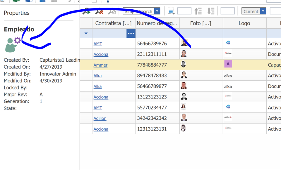

Hello
I hope you can help me, I need this image to upload, which is the employee identification photo, to be loaded where the ItemType logo is,
How could I make this possible?
Hello
When you change the name of your property from "foto" to "thumbnail", your photo will be displayed like the regulra Part thumbnails below the State: in the properties pane.
