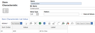

In 'Item Characteristic' which I believe is standard object, there are three fieds as below:
'Sort Order'      'Value'       'Label'
I tried to enter text for new Item Chracteristic 'Construction' as above:
     10                   AIO          All In One

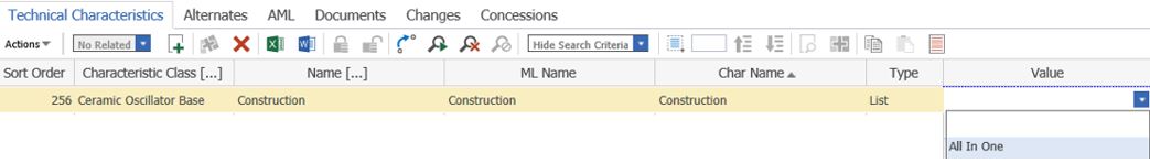

However, once I save it, when I trid to select this new item characteristic of 'Construction' in part screen with All In One' as below,

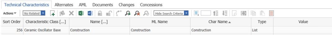

System save it successfully. But, system doesn't show 'All In One' in 'Value' field, once it refresh screen.
Is it impossible to maintain different text in 'Value' and 'Label' or should I maintain the same text in two fields?
