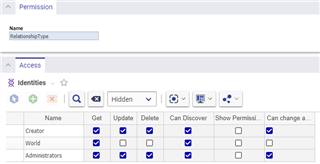

My guess would be that this is related to the permissions, but I can't say I've seen this issue before. Could you check the Permissions on the RelationshipType ItemType to see if it has been changed in your system? The Permissions in a default environment look like below where World should have Get access.
I have the same configuration as yours for the RelationshipType...

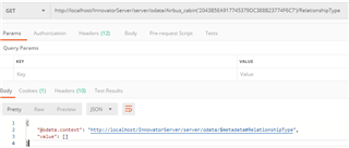

And here is the request :
Everything looks right to me...
Hi Arnaud,
I see the confusion now. You're querying the "airbus_cabin" ItemType. What you actually want to do is query the "ItemType" ItemType. The airbus_cabin itemtype has no relationship titled relationshipType, and therefore you're getting this empty array. It's also important to note that the ID you need to pass in is the ID of the airbus_cabin itemtype.
