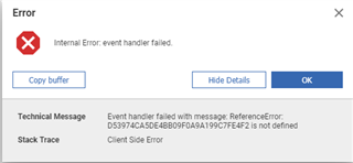

The URL worked fine! But when using the method gave me an error:
Any idea what i did wrong?
Sorry, just a amateur misstake, i forgot to put ' around the itemid in the mthod, now it works fine!
