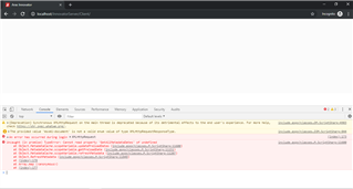

Installed Aras 12.0 and I get following empty screen with js error after login.
I also have the exact same issue, same error [Uncaught (in promise) TypeError: Cannot read property 'GetAllMetadataDates' of undefined]
